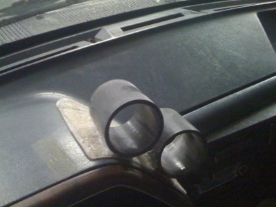

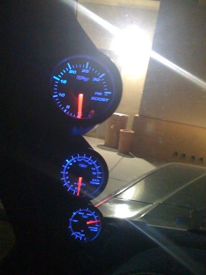

its from the 92-what ever years with the top and bottom cut off..it looks really good..here are some pics. Im working on fiberglassing the other 2 gauges i have.. i actually wrapped it and fiberglassed it just havent cleaned it up and smoothed it out yet..

i have the same gauges. i have them mounted in a pod on the dash above the radio facing me. during the day i cant read them at all. not even alittle bit. but boy at night they are beautiful!
