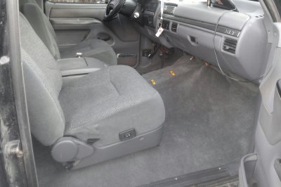

homelessduck
Oct 2, 2009
2,708
298
I switched to manual valves awhile back. I love them. I can pull from and return to whatever tank I want.
