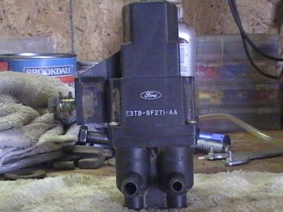

ok so my truck runs fine on the front tank but when i switch to the rear tank the fuel filter light comes on and then my truck starts slowing down switch back to the front tank starts running fine and the light goes off i can blow through the feed line and the return line through the selector valve and hear it bubbling in the tank on both lines and the tank is full! i cleaned the vent on the tank its working properly and the filter isnt very old i do not have the screen on the pickup in the tank its a hose as the screen broke i also tried running the hose at the tank to a bottle full of fuel and it doesnt change anything :dunno
Your fuel tank switching valve is the problem. Sorry for the not so great news...
dagreendeville
Nov 7, 2011
164
eustis, fl
i was leaning towards that but i wasnt sure because i could blow air through it all the way back to the tank
338

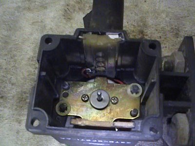

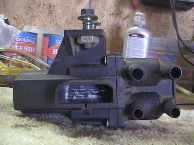

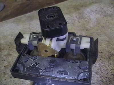

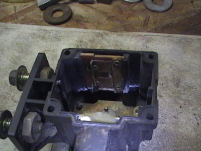

You can take the FSV apart and clean it, just watch how it comes apart. Even a caveman can do it.

Theres nothing like a great set of pics explaining something. I hate blury pics.. They are a complete waste of effort to show us something.... For me its a why bother question.. Se what I just posted in the lounge about quality pics...:sly

well after several attempts of getting this thing apart i broke *** guess im sol now i hardlined my rear tank in for now and runs great although i am getting an occasional flicker of the ff light after running at idle and when i go down the road it comes on but runs fine now
