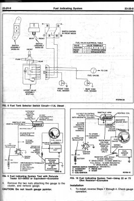

342
Fuel guage circuits from an 89 factory service manual.

Thaanks for the diagram's, those are the same ones i used for crossing the feul gauge wire and feul sender wire. Wich i asume should work fine since normally the selector would just do that internally.. I dont know, i just asumed if i connected those two wires together it would work??

I was just looking over the diagrams again, looks like i also have to jump the wires 1 and 2 in the plug as those are the wires for the switch that switches tanks, and the switch would be wired thru the gauge so the gauge could work either tank...
Think i'll try that and see if it works, if not i'll get a new pigtail and junk yard tank switch valve and just install the valve on the frame and plug the new pigtail into it so that the gauge part will work. Shoulda just letft it on in the first place, but i figured why have it on there when i'm only running one tank.

Fixed it, turns out wires 1, 2, 3 and 4 all need to be wired together for the gauge to work..
