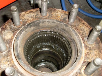

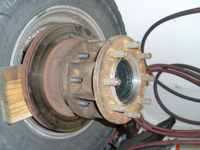

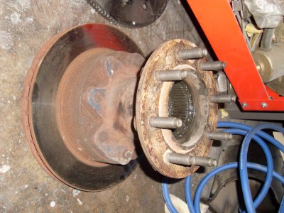

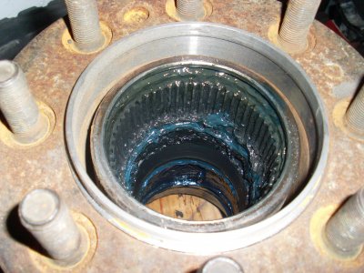

the fronts should be an easier sell than the rear simply due to the offset. The front isn't changing where the pressure on the bearings compared to the rear. here's some pics of a OE dually front hub and a Arrowcraft adapter
arrowcraft.
attachment.php
attachment.php
OEM
attachment.php
attachment.php
the rears otoh, aren't as good of an idea due to the lack of material in keeping the wheel centered on the hub. if you are not towing heavy, you can compensate by using a centramatic wheel balancer system. check out this thread....https://www.oilburners.net/forums/showthread.php?73850-what-are-these-between-my-duals.
Under no circumstances should one consider using one of these as a spacer BETWEEN dualls. it is not what they are designed to do and is not legal. why? the rotational forces of the wheel will shear off the studs on the hub. A simple analogy is using a breaker bar. With no breaker bar, the force is what you put into the effort. with a 2 foot breaker bar, your force is now multiplied by a factor of 2. 10lb of effort, 20lb of force. These wheels easily weigh 100 lbs static, we're not even going to try to factor the spinning weight, but you should be able to use your imagination if you add a spacer.
