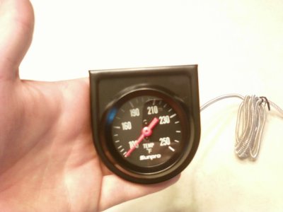

I just got my Sunpro 2 inch mechanical water temp gauge.;Sweet
Only cost me $20;Sweet.
I don't want to speak to soon but i think the install will be easier than i thought. since it is mechanical it just has the probe that screws into the block. then i just have to route the probe line into the cab and mount the gauge. i allready figured out were it will be mounted. the only electrical work i will have to do is wire the back light up. For now i am going to wait on that and just get the gauge functional and see what is going on with my temps.
I had a thought while i was out shopping. if i was to start the truck now, it has been sitting since last nite so it is plenty cool, and the engine temp light camr on right away, would that indicate an electrial problem with the engine temp light sender rather than a physical overheating problem?

Thats the mechanical gauge i was referring to. They are very accurate and reliable.

That'll do just fine, and you can pull power off of your dash dimmer/headlight switch so that the gauge backlight goes up or down along with the rest of your dash instrument lights.;Sweet
