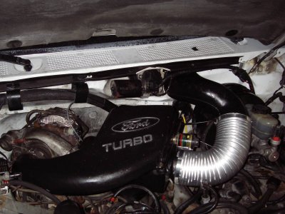

I like It
:thumbsup: EGT,s droped a bit how much is hard to tell maybe 50 deg at highway speeds. The most noticable improvement is how much slower the temps rise and it levels off quicker once I get to crusing speed. I don't know if this is all from the cowl effect or if its just breathing better because the stock intake was a restrictive POS, maybe a little of both :confused: Didnt feel any power difference and boost stayed the same 10 PSI.

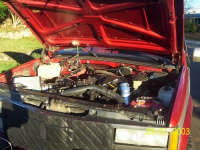

Your guy's homemade jobs look as good
and as effective as the store bought kits.
Good job guys. Nice to see others are thinking
along the same lines as I've been.
I'm going to one day get around to doing
a similar setup in my GM.
Thanks for the pics and ideas. :thumbsup:
I'm just not sure if there's room for it.
