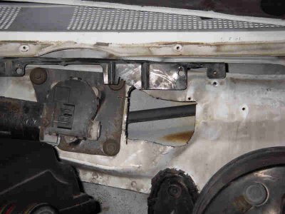

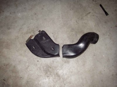

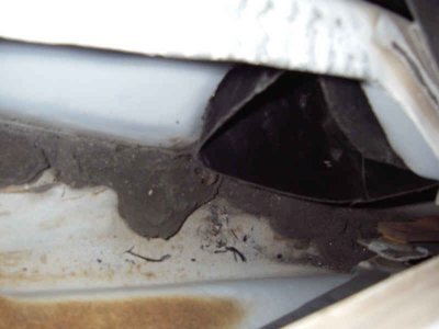

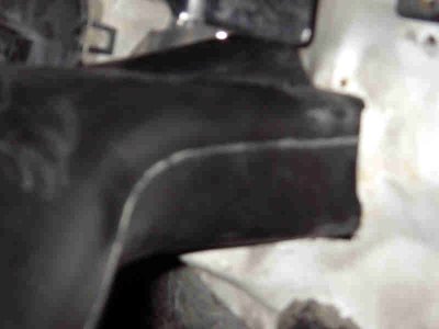

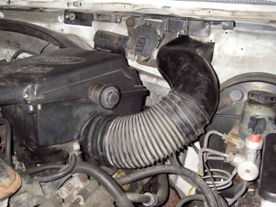

HOMEMADE COWL AIR
I been thinking about this for a while so after I saw this thread I had a few beers and grabed the grinder :eek: ;Sweet I used the factory turbo intake cut it (see pic) cut a hole in the cowl shoved it in sealed both sides with 3m 5200.The picture shows the stock plastic intake tube but it was to short got a alluminum 4 inch duct tube at lowes and 2 hose clamps 11.00 total cost for THE REDNECK COWL AIR

I took her out for a quick test flog tonight and noticed a difference in my EGT's and the turbo whine is more noticeable ;Sweet I'll take a better look on the ride to work and get some real numbers. My next project is an intercooler so I did the cowl air to save room for the IC plumbing.

Now this idea I really like!! ;Sweet 94 Turbo - that looks surprisingly good LOL musta been the beer! :thumbsup: Really though looks as good as the hypermax setup. Hmm yah got me thinking I'm liking this better than hacking up the rad support too! Plus I wouldn't have to remove that big ole brush guard I got up there. I take it there is just a big cavity (void) up under the cowl where you shoved the plastic cowl in?

yeah, that is pretty cool. really nice, 94.
i'm interested, but i have to sat that i get a bunch of pine straw in there :mad: i wonder how much it'd help my N/A?
Eric, i think that last pic is looking down with the cowl removed.

Yea there is a lot more room in there than I thought and it was clean no leaves or anything the black gunk in the picture is the sealer ford used :rolleyes: I scraped that crap out sealed it with a bead of 5200 so the rain water could drain easier

Very cool 94! Do you have a pyro? I definately will be interested to see how much your temps go down with this! I think I just found a project for Saturday? Is there anything to worry about cutting in the firewall? Or is it pretty much a straight easy shot? Thanks for the idea!
