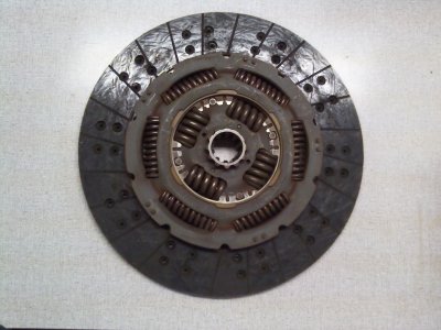

i did the zf conversion on my 90 F-350 and put the solid fly wheel in it and a used clutch set that came with the tranny and the clutch disk makes a horrible racket , and when i pull the tranny to rebuild it i want to put another clutch disk in it. Does anyone know where i can buy just a clutch disk ? or does anyone have a good one they would want to sell me. any help would be greatly appreciated !!:dunno
I've done three SMF clutch jobs. Two were LUK and were quiet, and just used ATF in the ZF. The other sounded like hell. The LUK disc has 10 springs, pic below.
