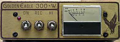

Is this anything like yours?
On Edit: I just reread your description of yours and yours has rocker switches not what this one has.
I just went out in the shop and brought my unit in here to the keyboard.
On close scrutinization, I can see no manufacturer identification, save for "GOLDEN EAGLE 300" and "BI-LINEAR AMPLIFIER"
The cabinet is black metal.
The face is grayish-blue metal.
It is made atop an aluminum heat-sink, much like a battery isolater.
It does not have a gauge like the one pictured.
Also, there is a 3-position rotary knob that I neglected to make note of, marked L M H ; for LOW, MEDIUM, and HIGH I am assuming.
I am guessing the L M H knob adjusts output strength, right ??
Thanks for posting that picture; I am sure it would help if I had sense enough to also post pictures. :(
