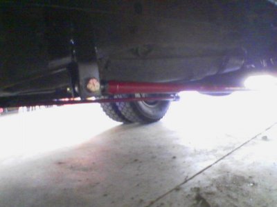

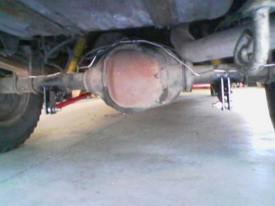

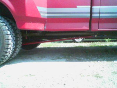

All these truck do it, a lifted truck just makes it worse. I built my own traction bars out of .120 wall DOM tubing and 3/4" helm joints on each end.
It rides a whole lot different now and the wheel hop is gone:peelout

Those things are the cats ass Steve!;Sweet
Rancho used to make those things bout 10 years back. Had a set of em on a V-8 Ranger that liked to deliver the mail.
That truck hooked so good with em, I was flexing the paint off the frame rails.:eek:
I'd love to get a set of em for Goldie.;Sweet

Do those things help cut down on the hop when taking off with that 5er hitched up

I would go at least .250 wall on the thickness, 1/8 is too thin... you will eventually bend those, ask me how I know:D

there are a bunch of kits out there if you want to buy a set. If you want to make them, be sure to keep thm inline w your driveshaft . Other wise you will have bind
Yes, its like a different truck now. As far as bending them, I was concerned about this too but the shop I bought the parts from said they have guys using there tubing on race cars and in truck pulling with out issuse. If I ever feel the need to reinforce them I can run a second bar from the top of the axle tube into the first bar like a triangle.
I had $160 in parts, had the 1/4 flat steel already. I got everything in a 4-link kit from QSC components in Muncie IN. and I have 4 Helm joints left over for the next truck.

I bought my hiems, tube adapters, and tube from the same place, and brackets and link tabs from ballistic fab. I went with 1/8 wall thinkin it would be fine. 500 miles later they are bent to hell.
I think your lift and tires put more strain on them than mine due to the angles. Maybe I will go with a thicker tube on the next truck since it will be lifted. At least maybe make a ladder bar type setup.
