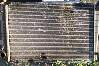

Now today Monday, I get up round 09:00HRS + - a few. I drink coffee, wake up and evaluate my situation. I yank the rad and find not just the first set of damaged cores but now a second set on the upper edge of rad hosed too.
Well I carefully cut all the fins (right through) on the rad out around the damaged cores. I start to cut off the split and damaged area to create clean cuts and fold those back to make a temporary fix. Call the local rad shop and hes familiar with this and can (GLUE) get that glue the rad with special glue.

I get to rad shop and pull rad out. Repairman glues rad. (pressure tests) shows only 1 small leak. At that point he had only glued the lower part the worst, my cut/fold/crimp was holding tight on top repairs, but I asked him to glue em anyway.
