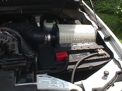

I did mine from NAPA with a short 4" exhaust cut down to 6" long, a constant torque clamp and the filter shown. It sits on the inner fender where the old one was. The intake air temp sensor is wire tied to the fender brace just behind the battery, you can see the white zip tie holding it. I get my filters from International, Fleetguard AH1141. It has been there since 8/7/2001 and has been fine.
