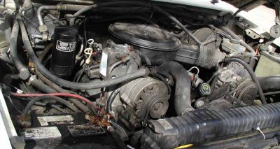

The Warden said:
Do you have any overall shots of the engine compartment? I'd love to see a shot of the heater box assembly on the engine side...that'll help determine whether your setup is a factory one with a different compressor (something a previous owner did, maybe?) or if it's dealer-installed.
Attached is a pic that is most of under hood area.
