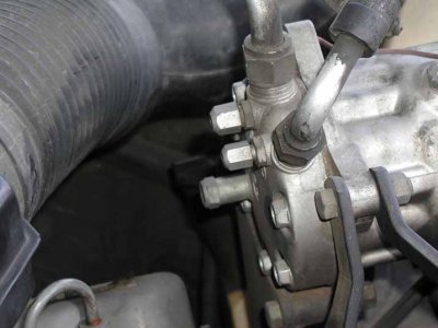

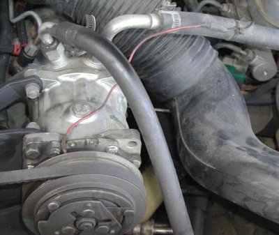

I don't see a switch on the compressor only a single wire to clutch coil. Thats the one I can hit with 12v and the clutch will kick in.
The system was recharged but don't know if it was checked for leaks. I just ASSumed it was. You know how that goes!

There is definitely only one wire that goes to my compressor. I can't find any terminals that may have come unplugged nor do I see any loose wires.

There should be two wires going to the pigtail that plug into the clutch at least. Maybe they didn't put this switch on the older trucks, or yours was modified.

Maybe AC was dealer installed, doesn't really look like a mod job. Doesn't look
like factory harness either.

That's definitely not an FS-6, nor does it use the same bracketing (at least from the pics I can see). Do you have any overall shots of the engine compartment? I'd love to see a shot of the heater box assembly on the engine side...that'll help determine whether your setup is a factory one with a different compressor (something a previous owner did, maybe?) or if it's dealer-installed.
I thought that most dealer-installed setups either used the FS-6 or a York compressor...that one in the pics doesn't look like either...

that was dealer installed air--done a few--and thats the comp they used--you only have the switch on the drier--
