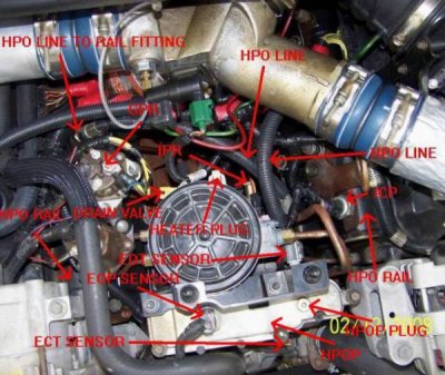

CRANK CRANK CRANK to get it started, Check the ICP, if it has oil seeping out of it by the wires, it needs replaced, check the tin nut on the IPR, if it's loose tighten it, when loose it lets the solenoid coil possible slide back. You can check the ICP by disconnecting it, the PCM will take over the IPR pressure control then, if it starts quick, then the ICP is bad. It has to crank over pretty fast, needs 450 psi HPOP to start.
