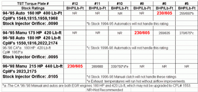

The 11 looks kinda like two sevens stacked (to me):
I adjusted the lever up to hit the plate at take off about 1/2 way up the lower ramp.
The guy that has helped me so much with mine has a '0' plate in his. I would not recommend it for towing unless you have major air mods that keep it cool. He does and is making around 525 hp and his pyro didn't go past 900 deg F on the dyno. Mine, well it was pegged from about 2300 rpm up.
I'm posting the plate chart from TST's website. It looks like you ought to be doing a #5 or #6.
