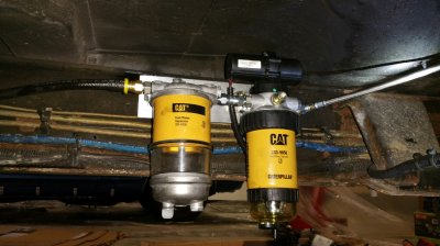

I installed a cat filter/pump setup, it's 5 micron, could probably get away with that but i put a 10 micron on before it just to make sure i dont clog the filter faster than i should.
