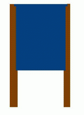

These sleeves have a lip at the top that must be machined in the block deck like a wet sleeve engine and you do not bore all the way down.

About $30/ea plus the block machining, might be better than looking for a good block that may end up not being good. And then not having to worry about cavitation ever again.

It is the way to go I will not build one anymore without sleeving all 8 now. Plus in future you now have a sleeved block so if you need to rebuild again you can pop in new sleeves.
The picture of the sleeve is interesting but... That is very hard to install with two step areas for the sleeve to rest on. I agree with the top lip as thats the best way to capture and hold the sleeve in the block. About the sleeve not going farther down in the bore. Thats just sounds wrong but maybe its working. I think it could work but the thought of the piston skirt catching the joint is scary at best. Maybe the bottom of the sleeve doesn't rest on the bored block cylinder too. That way only the top lip holds it in place which in my oppinion is the better way to hold in a sleeve by using the head as the clamping force. I've had 2 sleeves slip because the crappy shop didn't know what they were doing... I don't deal with them or recommend them to anyone. I also tell others I meet with to avoid them for good reasons.

The lower lip wouldn't extend out as far as the bore size ( the pic doesn't show an internal bore), just a step to help support and stabilize it. If done right, that would be all that's needed and nothing done at the top. But having both may be the best if machined correctly.

A single step at the top or bottom of the sleave would probably eliminate all but the most extreme sleave failures. Having 2 steps is better, but I think it might not really be needed. Just think of the number of IDI blocks out there that could now be refurbished properly........

The good ones with 2 steps are not actually for an IH but work the best.
Also you don't have to worry about the piston catching because the piston rings do not travel that far down the cylinder.

mine were put in with the step on the bottom, and the head holds them down. no problems. had a sleeve put in a 428 same way--no problems!!!!!

The only sleeves I had heard about for th IDI before this thread had no step anywhere and were held in place with some sort of locktite crap. Dave Sponaugle (ford trucks.com moderator) went through three sleeved 7.3L engines before starting the fight for a full refund.
