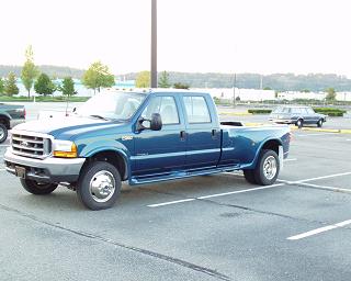

Actually he just got the truck last spring brand new - it sat on a lot for a couple of years. Still has less that 15K miles on it. Warranty is intact, but since it's a F550 - Commercial vehicle I think the warranty is different. He paid $32K - I'm betting the truck is worth close to $50K
Heres a picture of it - it really is a pretty truck....

Your right that is a nice truck..a 99 with that few miles wow
