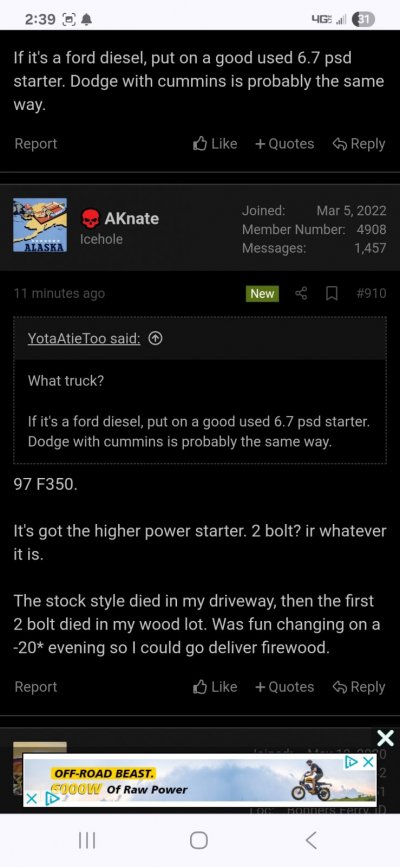

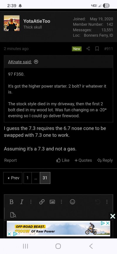

I just ran across this on irate4x4
I'll get the rest later...
