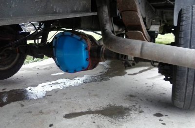

3 73 with no L it is the open way the SD open diff looks. You evidently have to split the case open and weld the spiders and set them back in!
13,324
3,897
when i opened up my 10.5, the other side had a little bigger opening..

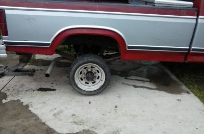

Now I have to put in the U-Joint straps, pick up the tires tomorrow, and adjust the E-Brake (thanks to the awesome idea I stole from bike-maker) and she is ready for a maiden voyage. The only concern I have right now is the lack of free play in the driveshaft slip joint. I only have about an inch at each joint of the two piece shaft.

Glad to help. On mine, I also had about an inch of free play on the slip joint (after move my the axle 1" back - still need to rectify that). And it seems backwards, but the tightest the joint got was as full droop - when the rear axle extends toward the ground, the increasing arch of the leaf springs pushes the axle forward.
So hook that tractor to the ass end of your truck, pick the rear tires up off the ground, and if you still have travel left in the slip yoke, you should be golden.

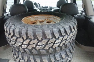

Bike-Maker I noticed the same effect when lifted. With tires mounted and and an hour of driving there is a definite difference. I used to think the converter was going in the trans because of how much rpm it took to get going...not anymore! I get the feeling my 21mpg is probably done though. ;)
