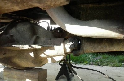

Well I bit the bullet and bought a 04' F350 (SRW) 10.5 Sterling with 3:73 gears to go in the beast. Pulling the tractor on a flat bed with 3:07 gears was no fun but pulling the new 33ft camper was murder.

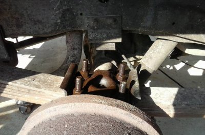

After getting home with the axle this afternoon and stripping all the old stuff off it was time to start yanking the Dana 61. I ended up cutting two of the u bolts and will have to call around to find some in the am.

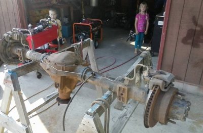

The next issue I see is the u-joint size difference. All the searching I have done seems to show that my Dana should have had a Spicer 1350, but the caps seem to match a 1310? The sterling has a flat pinion yoke that will need to be swapped with one from an OBS? If anyone knows what joint an 84 F250 model 61 one should have let me know. What is the best year model to get the yoke from 93-97?

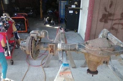

It took about three hours by myself (well the two year old did hit me with the mallet) to get it out.

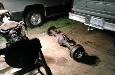

But out it came finally!
