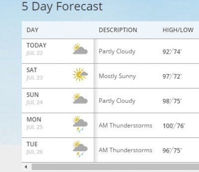

I actually just ordered a ac line from the store about 30 min ago. I won't have it in time for the heatwave but I did fix the ac in cough chevy cavalier cough. Hey it was free
Heck tomorrow I will be out all day at the range with no shade in battle rattle.......I will probably end up drinking a gallon and a half of water just to stay alive!
