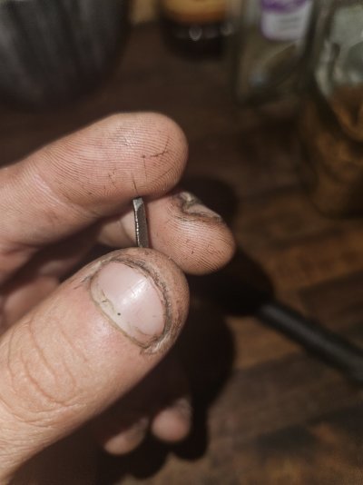

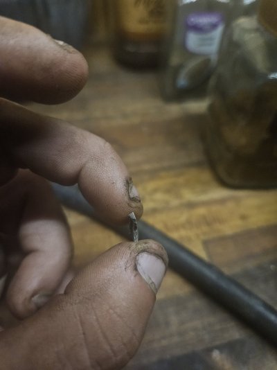

I think the chunks are too thick to be the valve keepers. I'd still bank on debris got in there the last time the valve cover was off. I've seen all sorts of weird things in there on multiple engines.

Sorry its been a minute. Jeez, fellas, looks like Im gonna have to start an onlyfans for my hand pics
Anyway, I havent been able to open the valve covers again the last couple days, but that cast piece is way too big to be part of any of the springs themselves. I think I may have found what it is part of, though, based on the shape, contour, and thickness of the fragment.
I dont know what the part is actually called, but it looks like a fragment of one of the parts at the bottom of this photo. Does it check out that that part would end up in the valve cover if it broke?
(i dont know about on pc, but I have to open the photo on mobile to see the part Im referring to.)
Nice hands.......but really, I don't think it's a spring keeper. It's too flat and squarish, I think.

I agree with @Nero I don't think it is a valve retainer. Looking at the picture you just posted could it possible be a piece of the ( I'm not sure what the technical name is) piece that goes on the bottom of the valve spring? Between the spring and head.

Hm, okay. It has a pretty broad curve to it, like it would be a broad cone or some curved shape. Smooth on both the inner and outer face. That was my best guess.
I now have white smoke on start-up, a hum or vibration from what seems like the intake, and a quiet chuff coming from the passenger side on acceleration. Hopefully it isn't too serious. This is my daily driver
