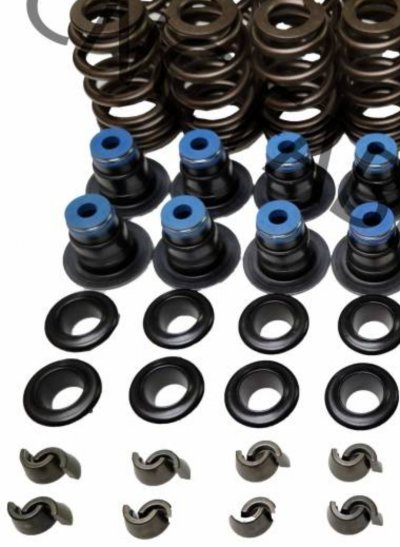

The cast piece I'm really not sure.

Sorry its been a minute. Jeez, fellas, looks like Im gonna have to start an onlyfans for my hand pics
Anyway, I havent been able to open the valve covers again the last couple days, but that cast piece is way too big to be part of any of the springs themselves. I think I may have found what it is part of, though, based on the shape, contour, and thickness of the fragment.
I dont know what the part is actually called, but it looks like a fragment of one of the parts at the bottom of this photo. Does it check out that that part would end up in the valve cover if it broke?
(i dont know about on pc, but I have to open the photo on mobile to see the part Im referring to.)
