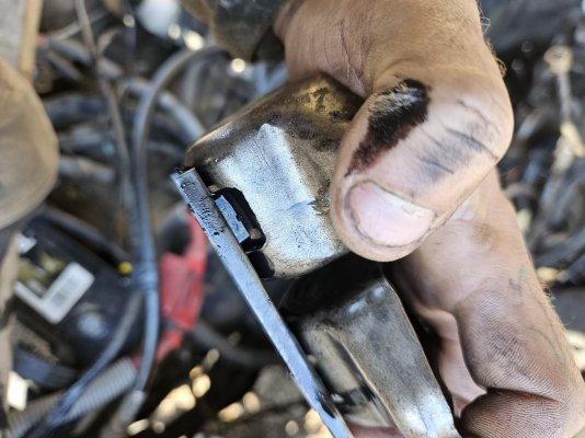

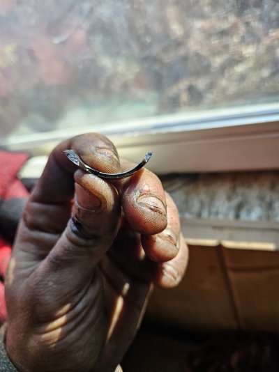

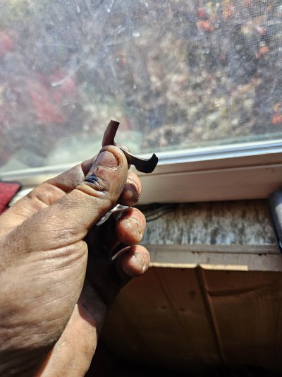

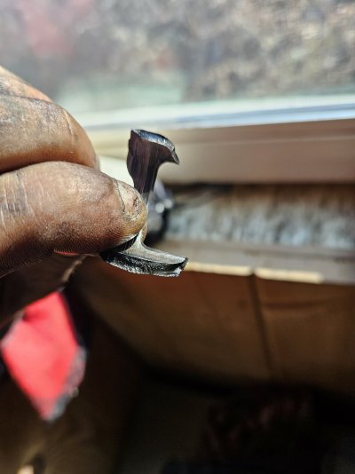

The mystery continues. Put cyl 7 at TDC, pulled the rockers, and found more shards of our mystery object. The rest of the pieces are nowhere to be found. One was lodged in a galley in the back corner of the head. We got any new guesses as to what it is? Turns out "broadly conical" was wrong lmao.

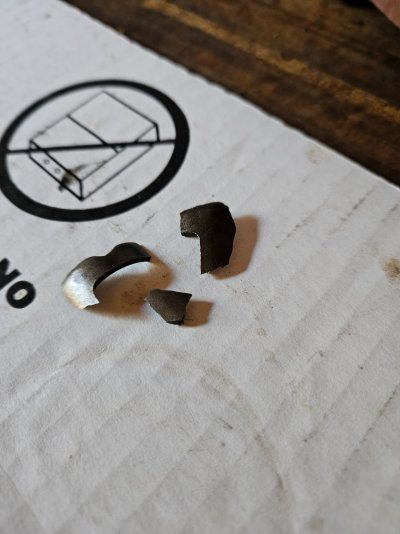

busted rocker somewhere. fugured it out

....... well, I be John brown!...... what were you doing with it to break that?
Apparently nothing, because it isn't from any of the rockers that are in there as far as I can tell. I put every cylinder at TDC and took them all off to inspect them. Looks like someone must have actually left a gigantic piece of rocker in there.

Heres one of the other pics of the shards for instant gratification while the other post awaits approval.
