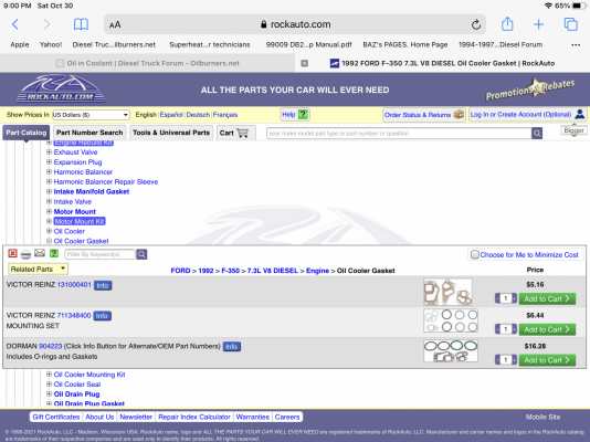

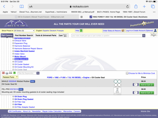

Quickster has the right idea. I buy my oil cooler seals from Rockauto.
Victor Reinz gaskets
Mahle o rings
