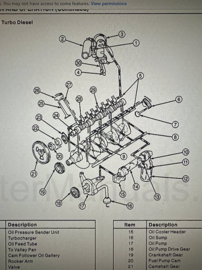

Oil feeds to the rockers thru the heads
?no?
The service manual I have doesn’t show the head or block outline in the oil passage diagram but it looks like the rockers are oiled through the push rod as far as I can tell

Hows it return?
Thru the head gasket into the block/ valley...

Hows it return?
Yes there is return oil through the head gasket but it’s not under enough pressure to get into the coolant from there, it is possible the coolant could get into the oil with a bad head gasket but I’m not sure how close those passages are
