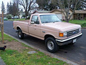

I've had a couple trucks with 6.9 IDIs in the past, and a gas hungry 460 recently, but I've always wanted a 5 speed truck. I picked this truck up a week and a half ago and just got around to tinkering with it today.It's got 115,*** miles, and is pretty clean for it's age. The previous owner was the second owner, and had the clutch replaced(SMF), as well as the starter, IP, and Injectors. It sat for 6 months with some questionable fuel, so I had a intermittent stall on return to idle condition, which an overdose of ATF and Stanadyne additive in a new fuel filter has seemed to cure. The only other pressing project yet to be completed is an oil cooler reseal(and oil+ coolant change at the same time.)
I'm also going to need fuel tank sending units, which I don't imagine are particularly cheap. Do sending units differ between diesel and gas trucks?

sweet looks clean
all fuel stuff is diesel specific

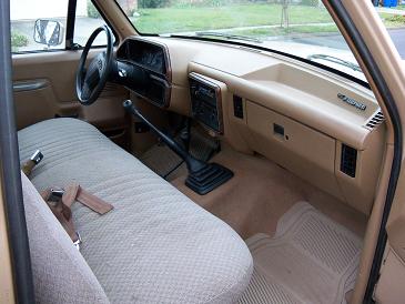

That's a real nice looking truck there! Too bad it's only an XL model, but at least it has A/C, those dash vents can be a life-saver in cold/hot weather. And here's a suggestion for an upgrade - find yourself an XLT seat, they have the bottoms and the back shaped like bucket seats where the driver and passenger sit, and there is a drop-down armrest in the middle (but with the armrest folded up you can still fit three people reasonably comfortable).
Man you'd hate my F250, it's a Custom! LOL
It's got NOTHING! 2 speed wipers :D
My A/C has always been the little vent windows open all the way around, and the wind blows directly on you. Feels good.....untill a fly or bee hits you in the chest....
