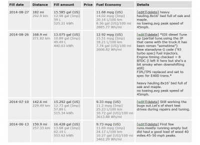

also her second tank calculation is in.another just barely over 9 mpg.now with the tune up and no more short test runs,hopefully she can best 10,perhaps 10.5 mpg range.perhaps that's all the 5.13's will allow too.wont know now until i use her some more,but i now dare to take her out on a few real jobs further out.i think she'll prove herself just as reliable and dependable as chip truck......knock on wood.

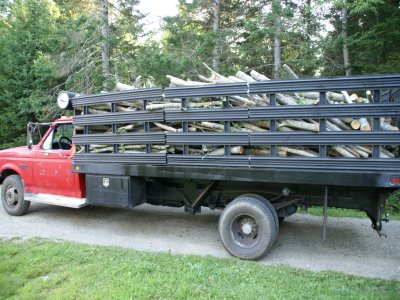

i just hauled 3 loads like this about 45 miles.she just did it like she was made for it.effortlessly.
she's got some steering wonder though.i need to grab another reman steering box for this truck.it's just about as bad as chips was.you've got to work to keep it between the lines (empty or loaded.)

79jasper
Chickenhawk
Oct 13, 2012
17,367
1,930
Collinsville, Oklahoma
What's at the front top of the bed?
Don't think I saw it in any of the other pics. Looks like drain/culvert tube.
