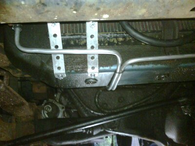

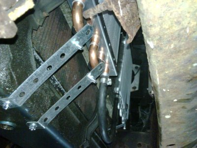

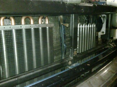

started with a pile of goodies...
and way too much money in one part...:puke:
then started putting it all on in an attempt to never EVER:mad: have to spend this much again at one time....
crap Autozone Haden cooler and Summit G4969 $83.95 30 GVW cooler
I ran metal lines because I HATE rubber. Summit G2538 $18.95 3/8" x 20'
threw on a spin on filter for good measure Summit G4980 $31.95
added a pillar pod Summit 15301 $21.25 and a Electric Gauge and sender unit Summit 5757 $48.88
hope this might guide you in the right direction. I have yet to see a temp over 165. I am on the freeway and stop and go traffic ALL day in Columbus.
OHH, AND A TIP ON DRAINING TRANS FLUID...JACK YOU TRUCK UP ENOUGH TO GET A CUT DOWN 18 GALLON TOTE UNDER THE WHOLE PAN. I did it this way to capture all my new fluid for reuse when I had to switch out the bad solenoid pack that was in my NEW transmission. And just so everyone know...I strained the HECK outta it before putting it back in.
