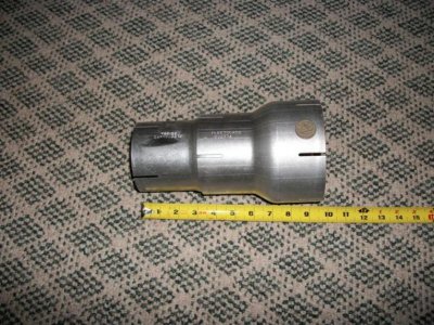

i have a custom built setup.
(back when i was SRW,and before a true full coat of por-15)
Custom 3.5" Single Exhaust.
1 Reducer 5" X 4" Fleetguard #89277A
1 Reducer 4" X 3.5" Fleetguard #89186A
Custom Mandrel Bent Y Pipe Flowing Though Joined
Reducers.
Flattened Sides & Welded To Make Custom Collector.
3.5" Into A Dynomax Ultra-Flo Welded Muffler #17224
she likes the extra flow.more power indeed.gets up to speed even quicker,and coming back on the interstate she got up to the higher speeds easier as well.
75MPH was quick and very easy to maintain (not that it wasn't before.but even more so now.)
very BIG & DEEP tone.
Dynomax 4" tail pipe part #54387
this one is not my truck (snaponprolies's.)but the same tailpipe i put on it since:
