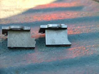

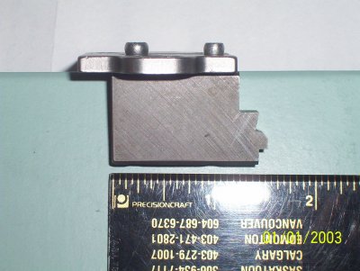

Take your stock plate out. Use a grinder to cut
it to a different profile. Oh, and it's free that way.
A popular profile is a number 10.
Here is a stock one, and a homemade number 10.
They don't have to be exact carbon copies of
the over priced store bought kits, although they
come with a boost elbow as well which you'll want.

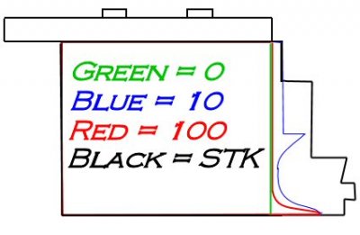

Like the rubber fish said............pull yer stock plate and grind it down.....then polish it smooth
I did a 100 plate for my sons 95 and it works very well
here is some profiles for ya
Oh a boost elbo is basically a restriction in the wastegate line that delays the reaction........works well....you can make that easy too

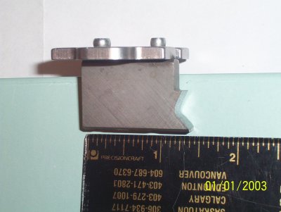

Whit
Dec 20, 2003
3,808
lost in Why-homing
Here is a stocker and a 100..................
a 100 is a good plate because the ramp at first holds full fuel off so its better for yer tranny and clutch but then its full fuel from there
notice that the 100 in this pic that the ramp aint near as thin as the one in the profile pics............I like the one with a bit more meat on it myself
