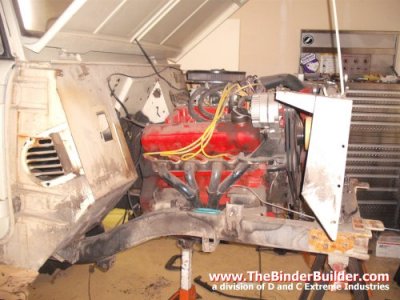

do they make our vacuum pump with dual pulleys? im looking at vaccume pumps to help run my vacuum wipers in the socut
Interesting idea with the serpentine. yea i kinda do need both because the setup will be 2 belts run the alt and water pump but the PS only runs off the water pump (cant run off the crank do to clearance) so for 1 belt to basically run the water pump, alt and the PS is a bit much
do not run a v belt backwards itll throw a belt
No no, look at your IDI:
- you have one belt between the crank, wp and alt
- you have another belt between crank, wp, and vac pump
That still makes two belts between the crank and the wp, like it is now.
