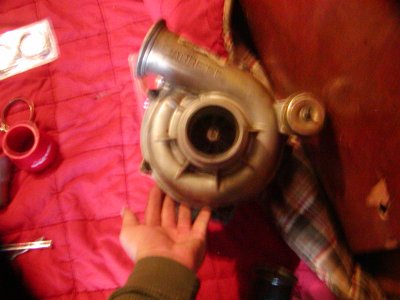

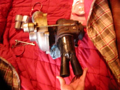

here is some pics of the turbo, i had to make another collector to fit on the idi truck i belive that mines will work great, not the prettiest thing but it will work for me, not had a chance to work on the up-pipes or downpipe yet cause i aint going out and laying in a couple inches of friekien snow in april-cuss lol its sprin break and theres snow on the ground ***

me too, im about to post a pic of the snow i could only get 2 pics cause my camera died.

well i took a wild guess at it when i made the collector, and i need to post another pic of it tommarow caue i changed it a little, but it starts as 2 1/4 and necks down to 1 7/8 then runs into the turbo, and i have 2 1/4 up pipes so maybe it will work good i hope.
