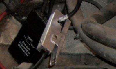

Hey guys, Im using a actron 7529 like others here along with the 765-1 ferret timing meter on my 94 7.3l idi turbo. Im having trouble getting my gun to pick up the rpm's? I have tried the Ferret on cyl 1 and 4 with same results. Ive sanded and cleaned both the lines. The 765 black box is blinking red like it should and its consistent. Seems like my gun inductor pick up isnt working. I did try it on a gas engine and spark plug...and it did read the rpms. Both tools are brand new. Any thoughts or ideas?
I have the inductor pick up on the spark plug side of the loop on the 765. Im not sure what else to try. Im going to go grab a different timing and gun and see if that helps.

Do you have the arrow on the inductive pickup pointing toward the sparkplug tag on the Ferret loop ?

I dont think the actron 7529 has an arrow on it...But I did try it every which way I could and multiple locations. The Innova timing gun did have an arrow...I pointed it towards the black box? I pretty sure I attached that thing all over the place...is there a specific way to attach to the 765? Such as between the spark plug tape and box or above the tape?

unhook the timing light from the loop,flip it (the clip,not the black box) upside down and try again.

it must be the piezo clamp.try sliding it down the line closer to your ground clamp.

Yeah, I did try moving the clamp all up and down the 1 and 4 line. Doesn't make any sense. The red light on the ferret is blinking correctly like it is picking up the pulse correctly....very frustrating.

yeah when I had issues I flipped the timing light clamp on the inductive loop and it worked. So that was my suggestion also.
Sounds like there maybe issues with the ferret.

The spark plug end of the loop was mislabelled on my Ferret meter. The tech support guy was not helpful. I finally figured it out by flipping the inductive clamp over 180 degrees just for S&Gs. I had my clamp in the middle of the loop. I don't know if that matters. It really shouldn't. :dunno
After rereading the post i see you have tried that. ;P
The blinking light should follow the RPM. If it does, that means the piezo connection is working. :)
