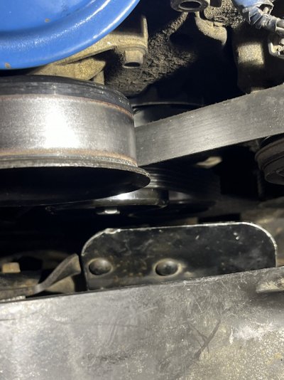

There’s stuff like this. You can tell it’s hitting or clanking on something. It doesn’t appear to be hitting the fan now, but it’s still making that noise in that general area

The tensioner is bouncing up and down like crazy. I checked all our other cars and they don’t do that. How would I fix that?
