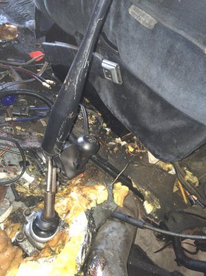

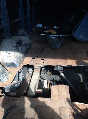

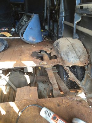

So i began cutting her apart. Friend of my dad passed away and had a bunch of 1/8th plate laying around. im going to start with that on the floor. This is certainly going to be a task.

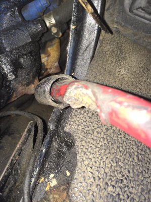

I am going to build a shelf behind the side door in front of the wheel well to relocate the batteries. i think i melted them when trying to move it monday due to the fact that brain surgeon pinched the starter line (the big old $9 a foot wire) between the block and the starter. guess what lit up when i hit the start key?

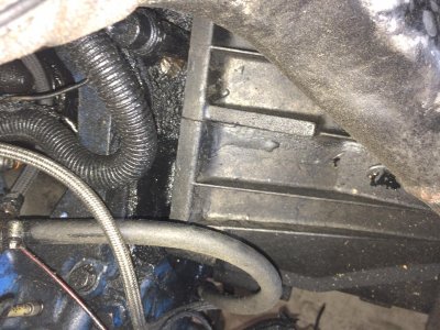

Figured out how he adapted a 2002 ZF6 to a 92 IDI. He didn't. It looks like the ZF6 has 6 bolts holding it to the block (never looked at the bottom come to think of it). the IDI doesn't have the top two. so he just simply never put the top two in. Now right dead center of them on the flange of the bell housing is a crack about 1/16 wide. when I pull the tranny to look at the clutch i will weld that up. But i do need to start formulating a plan to do this tranny correctly.

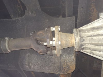

then dropping the tank i glanced at the drive shaft. while its true he got a custom shaft, he ordered it about 2 inches too short. so to make up the difference he went to home depot and got some zinc bolts and some big nuts to use as spacers and spaced the end of the driveshaft away from the end of the transfer case. i though that was awesome myself. shows real ingenuity.

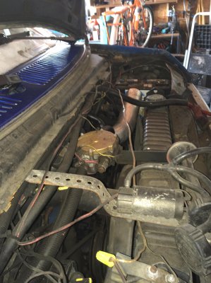

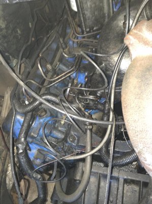

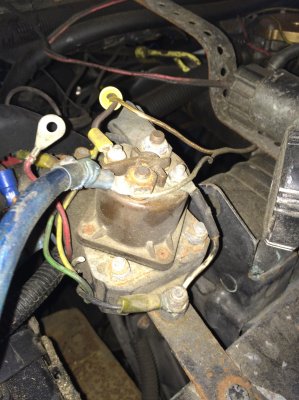

so you see the glowplug relay. i have an idea as to why its not working, maybe its the disconnected wires, or possibly the wire thats cut off. Or it could be the rest of the harness laying at the back of the block unattached to anything. Take your pick.

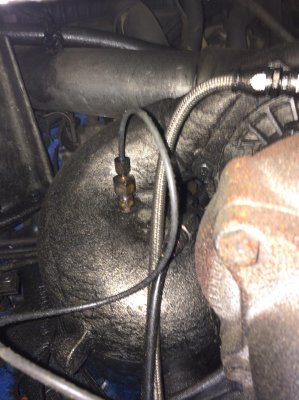

and you can see coming off the turbo, that coil of wire looking thing. yea, thats an oil pressure sending unit. its awesome finding that. Probably the only thing that saved me was the vacuum system is likely so screwed up the dump gate never opened and it never tried to spin. but who knows. it could be straight up seized.
But you can see a snip of the awesome wiring this budding electrical engineer did. i already have 600 feet of wire ready to go, i think im going to need more.
never in my wildest would i have ever thought the rust work would be the easy part. ugh.
