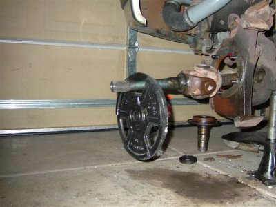

Well, at least I know all this work is going to be worth it. It took a lot of pb blaster, 8,567,321 different size flat head screw drivers, 2 good sized pry bars, a mini sledge, and way more patience than I have, but it’s off. ;Sweet :D
How do I know that this work will be worth it? Check out these pics, that’s a 10lb weight hanging off the end of the axle stub. :eek:
Now I just have to swap out that joint, and start on the other side. :puke:
