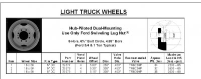

you can buy new.you'll need 4 but want all 6 so full tire rotations are not an issue.they are accuride 29578.they have the 5.35" offset as opposed to your current 5"
i dunno about the sims still working.probably they'll no longer be deep enough to work.going back to the 215's will probably be cheaper.
you can buy the rims here;
http://www.ricksontruckwheels.com/wheels-oe.php
