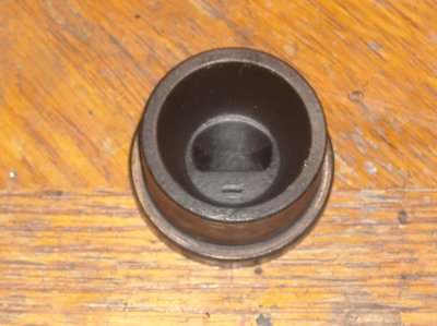

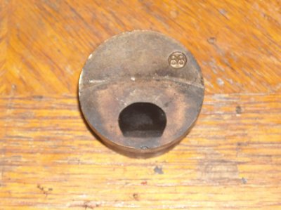

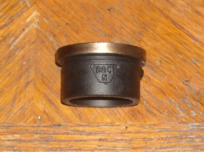

Does anyone have a pre-cup exactly the same as this one that would be willing to sell to me? I only need one to match the other 7 because there is one that is different and causing my engine to shake.

The one that is different from the other 7 has 88 cast into it as well but the hole is shaped different and I cant find anything else wrong with this engine to cause it to shake.
