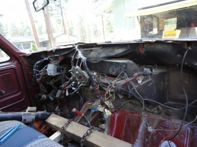

The transfer case adds a lot of mass to one side, and it wants to rotate the trans. Remove the t-case and the four bolts holding the trans to the bell housing. you can support the trans with a 4x4 and chain inside the cab.

I might try that. How heavy is the tcase? I'm a skinny *******, 5'7" 140. Not exactly the strongest. Lol

The t-case is pretty awkward. I am the same size as you and getting old. I used the skid plate loosely bolted on the drivers side and supported by a floor jack on the other end. I put a piece of wood under the case to keep it from falling. After freeing it I lowered the floor jack and wrestled it to the ground. I remember doing the same job when I was younger and just manhandling it. It will be harder to get back in place, taking it out gravity is your friend.
