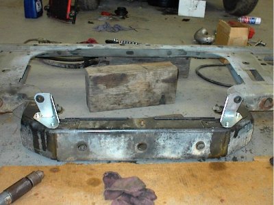

I hate to break bad news to ya but that core support will not work for a Diesel application. Been there.:mad:
Ended up having to split 2 core supports, refit and weld them to gether to make one work. A day's worth of work.:puke:
Here's what we did.

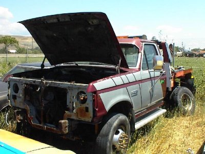

is this conversion for a towtruck? If so, you are going to want to put the bigger support in. If nothing else, you have a new support to chop and extend in order to accomodate the larger radiator. here's a pic of what I am referring to.
