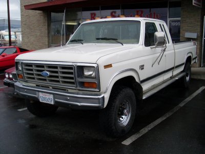

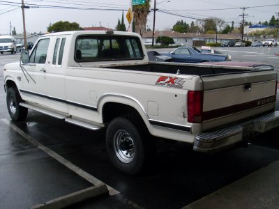

If you want to test-drive the motor first, I have one here. comes with a wrapper though. IE....if you buy the motor, you get the wrapper.
1986 F250 ext cab 4x4. good 7.3. body a little battered. bad part. C6 with 4.10 rear and front. motor is screaming down the freeway. $1800 will get you the motor, wrapper and a t18/19 bellhousing.
Truck used to be mime, buddy bought it from me and got busted a month afterwards. He's in club Fed right now and won't need a set of wheels for a very long time. Took me a year to get the title from him.
for the rest of the curious, the price is for Vegas39 only. I am mindful of the fact he went through hell with his truck a year ago and still didn't lose faith. That has to account for something.

Thats what makes this site .... BETTER THAN THE REST.....;Sweet:hail:thumbsup::yell::sly An $1800.00 aluminum bellhousing with a C6 truck thrown in free....:eek::hail:hail:hail
