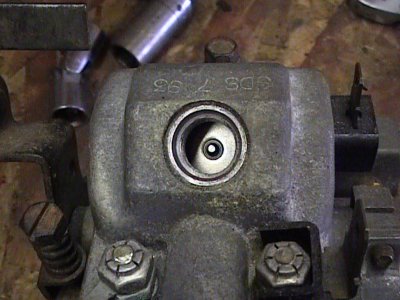

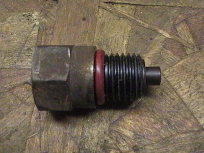

What do you mean by this? "we knocked the bb out on the injector pump" surely you didn't remove the check valve ball on the top outlet on the IP.

Surely we did. But we replaced it after finding out that wasn't our problem.
