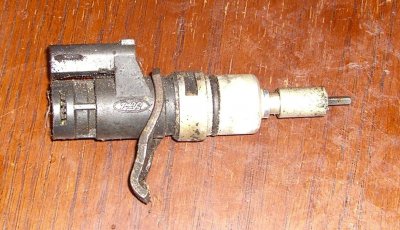

do you need one of these?
no gear on it but i pulled it from a 5 speed in a 88 t-bird. its yours if you can use it in your tranny.
