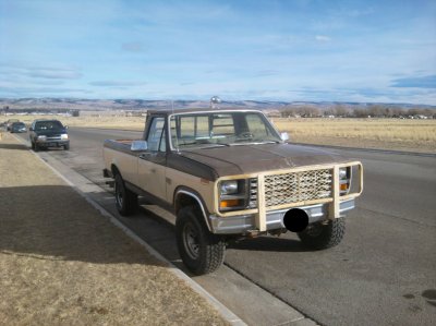

Just picked this up
69IDI
Sep 28, 2011
152
WY
86 F250 with a 460 and granny tranny. Fun truck

yep very fun truck...i loved the power of a big block when i had mine...i just hated the fuel mileage

X2 on that! I had a '77 with the 460, loved that truck and hated to see it go, but I couldn't keep my foot outta it and thus it bled my wallet dry. :rolleyes:
