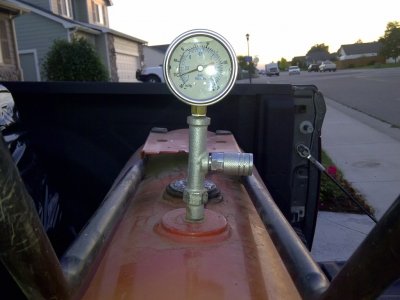

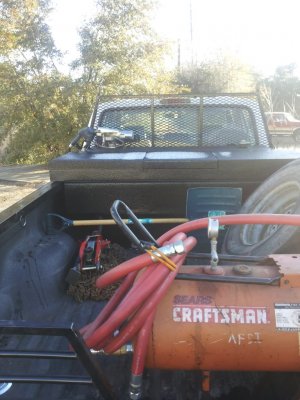

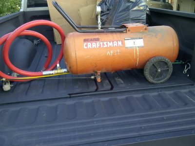

What is your super sucker?
That would be one of these.
Cliffnotes version: It's a storage vessel used to pick up your waste oil on site. It uses a vacuum charge to "sucK" the oil out of it's existing location into your "super sucker" Then you reverse the process by applying a positive charge (via an air compressor) to shoot the oil out of your super sucker into your centrifuge barrel. Done right, it has the ability to "suck" upwards of 1 gallon PER SECOND. Mines a little slow because I picked too big of hose size. It takes about 50 seconds to fill my 24 gallon vessel.
