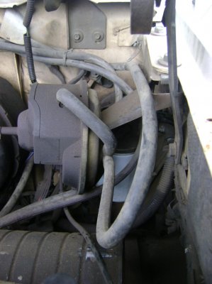

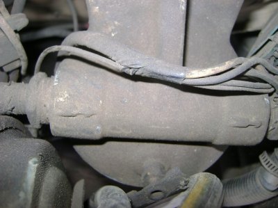

The filter is not the style that is over injector #1. I have a 7.3L filter housing that I was going to put on my truck, but I heard that the 6.9L filter will filter down to 6 microns and the 7.3L filter only filters to 12 microns. :dunno The "filter" assembly is located on the driver's side and the housing is bolted to the firewall. Here are pics. One is of the topside of the housing. Sorry the truck is so dirty, but I never knew that this thing was back in there due to being covered by the cruise control and all the hoses/wiring. I don't want to pull the filter unless I know that I can find a replacement for it.
The '86 F250 had the "pull plunger" style drain. This filter is on my '85 F350 CC in my sig.

Sure looks like a Napa or other brand of add on filter head. I have one similar, and at one time was mounted in the same location you described to me earlier. Took a 3210 if I remember correctly (though I probably don't) and it had a drain on the bottom. It's kinda hard to tell from your pics though.
